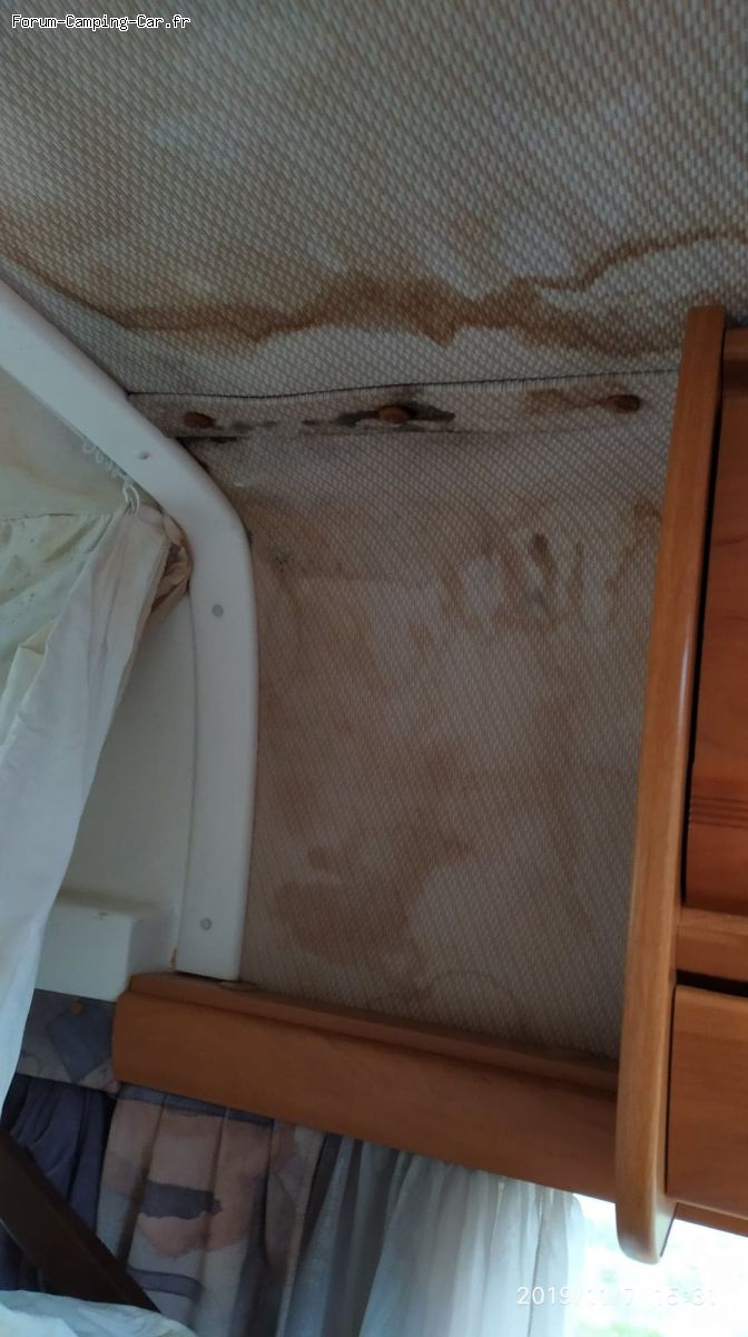

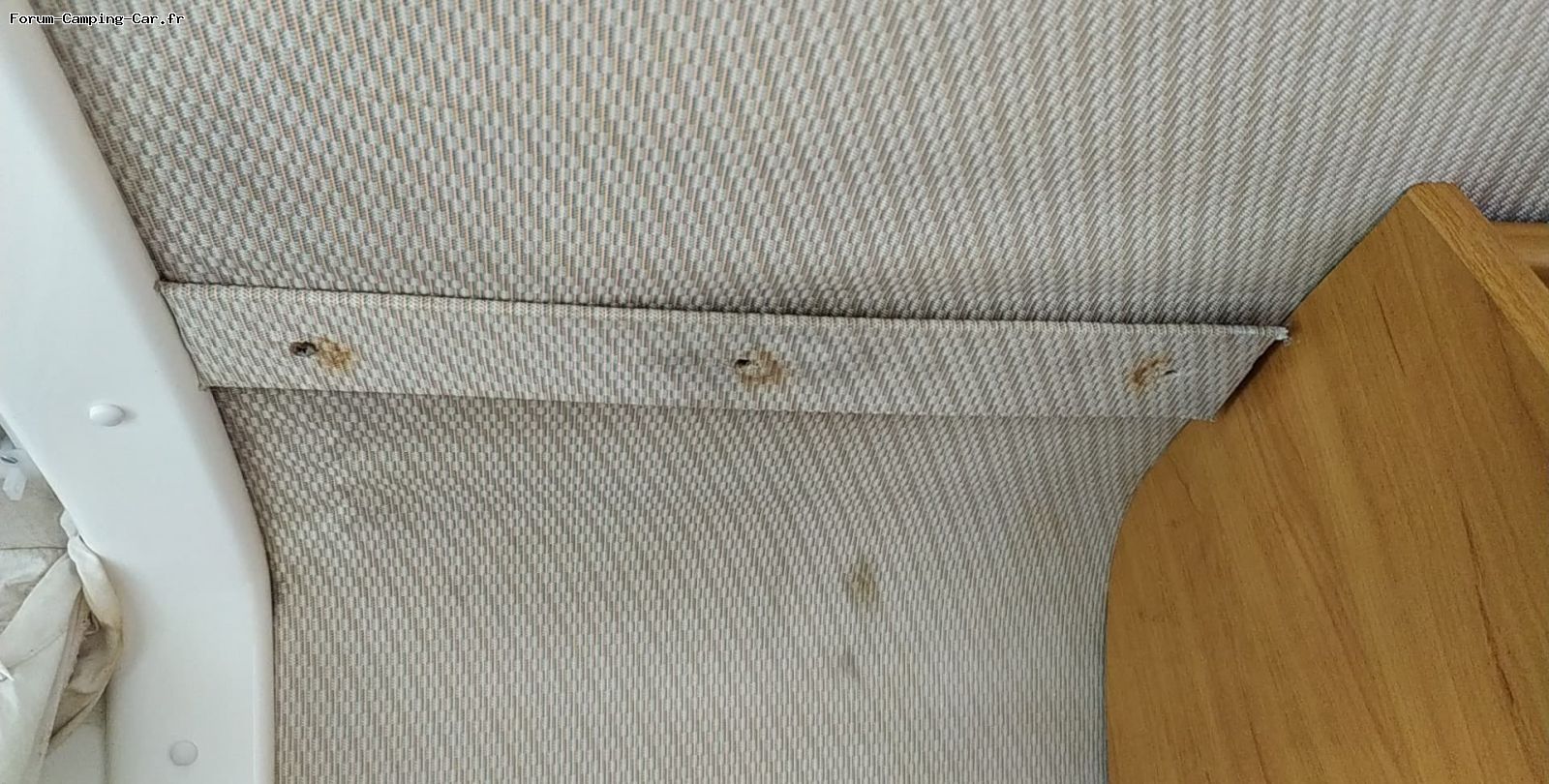

It doesnt look so good Charly...
Mine is 20 years old and I foind things as it.
So I had to work on it on the roof but still I can find some water downstairs and I have no idea where is it from?

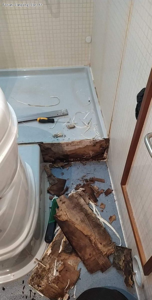

Same story on the bathroom
Posté : 18/01/2020 12:35 pm

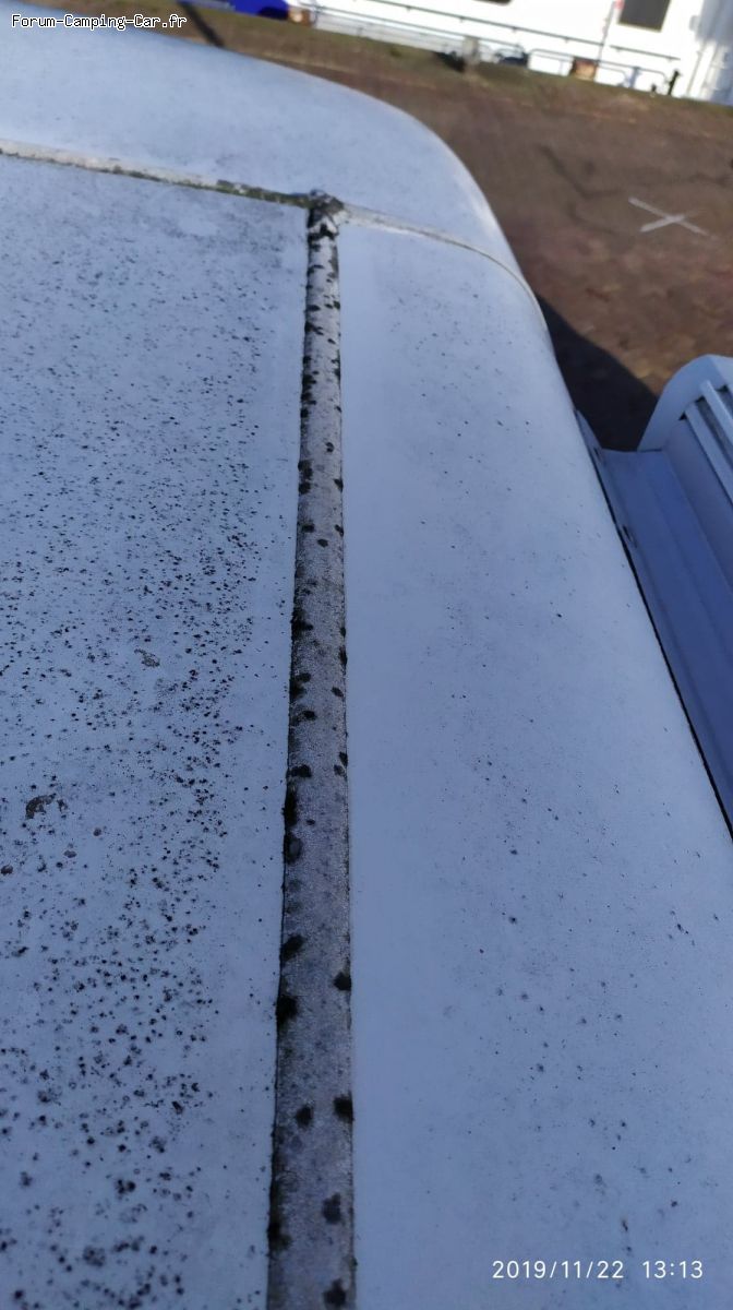

Heureusement, la structure des Esterel n'est pas en bois. Cependant, ce n'est pas beau.
Concernant les infiltrations à l'avant droit (photo 1), ne pas se poser de question. Refaire les joint (photo 3).
Quand vous posez la main sur la garniture intérieure, est-elle humide ?
Posté : 18/01/2020 7:09 pm
Problem from photo no 1 is fixed. Now is much better however it doesnt look like new but for sure its dry.
Posté : 18/01/2020 7:57 pm
OK. Comment avez-vous nettoyé les taches ?
Posté : 18/01/2020 8:01 pm
Some polish brand foam for cleaning car upholstery
Posté : 18/01/2020 8:20 pm
